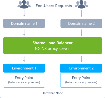

The Gigality Platform provides us with a Shared Load Balancer (resolver). It represents an NGINX proxy server between the client side (browser, for example) and my application, deployed to the Gigality Cloud.

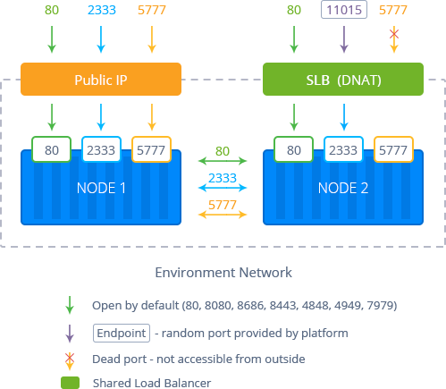

Shared LB processes all incoming requests, sent to a domain name ({user_domain}.{hoster_domain}), where the environment entry point (balancer, application server, or even database) does not have a Public IP address attached.
The common Shared LB processes the requests, sent to all of the applications, located within the same hardware node. In order to be protected from DDoS attacks, Shared Load Balancer is limited to 50 simultaneous connections per the source address of the request.

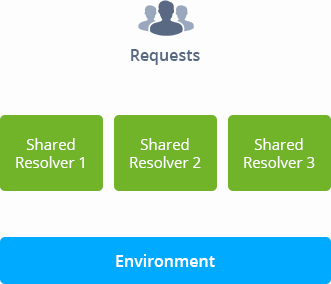

To increase the system's high availability, Gigality uses several synchronized Load-Balancers, placed at different nodes, for handling requests simultaneously. All of them work with a single data storage, which makes them fully interchangeable in case of any issue occurs at one of the instances.
As a result, there can be several entry points for users' environments, used at the same time. In this way, the incoming load can be effectively distributed.
