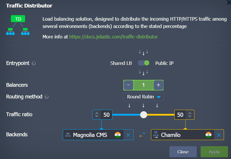

3. Within the opened form, you can re-configure any Traffic Distributor option just as during installation process:
Options available for configuration are:
  • Entrypoint - switcher with either Shared Load Balancer or Public IP position
  • Balancers - the amount of the NGINX instances, you would like to add to the Traffic Distributor topology
  • Routing method - select from the three available types of traffic distribution: Round Robin, Sticky Sessions and Failover
  • Traffic ratio - set backends' weight (priority) to control the requests distribution
  • Backends - select two environments to be balanced, either from the automatically fetched list of available ones from the account or type in the required IP address / domain name (for custom host)
    Tip: Using the Swap backends weights button, circled in the image above, you can quickly exchange the server’s Traffic ratio values.
Confirm changes with the Apply button.

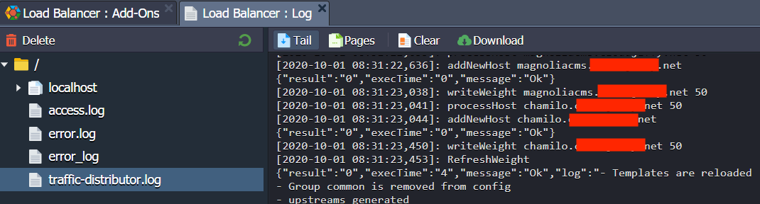

  1. After a while, You’ll see the corresponding success notification at the top right corner of the dashboard. Here, you can click on the Show Logs button to open the dedicated file. Within the opened traffic-distributor log, you can find information on the actions applied to the add-on with the corresponding operations timestamps and current distribution values:
Surely, you can access this log file manually at any time.
So, using the described steps you can apply changes to the Traffic Distributor and easily track them via logs.
